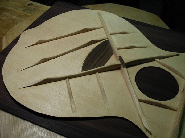

I've been doing my tops based on Dana's article since it appeared in the GAL years ago and like the results I get with it.
Here's a pic. You should definately read even if uou don't like the idea.
PostPosted: Thu May 11, 2006 3:55 pm
Jim, nice clean top there.
I realy like the rosewood x-brace cap. I do that on mine as well.
